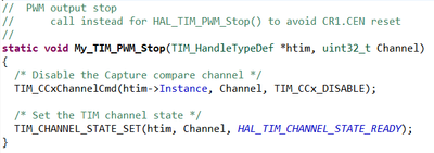

2023-09-19 12:02 AM
hello @waclawek.jan
thank you for your advise, and now it was solved.
I used HAL_TIM_PWM_Stop() before, but it reset CR1.CEN I found.
then I modify it not to reset CR1.CEN as followings, and works as well expected.
regards.
