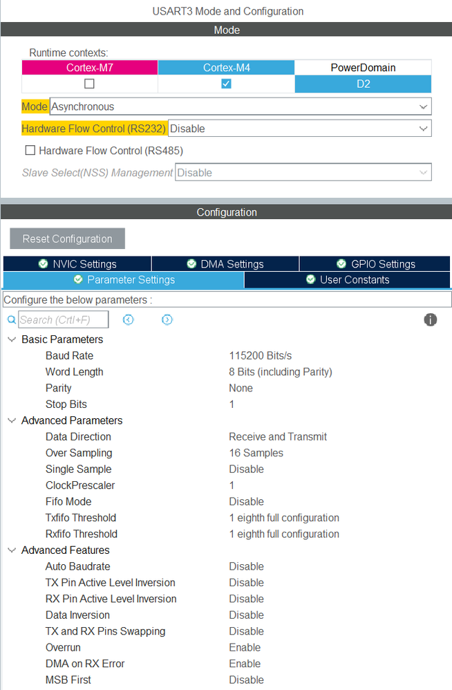

I have the USART3 peripheral enabled with the following configuration:

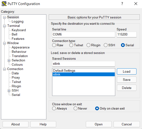

I connect to the port with the following settings in PuTTY:
The terminal connects, but I don't see my output string.

Thanks for the reply, the pins have been configured as so:Just tried that example and had no luck either.
2022-02-03 9:27 AM
Switching it to the CM7 core worked for some reason. Thanks!
