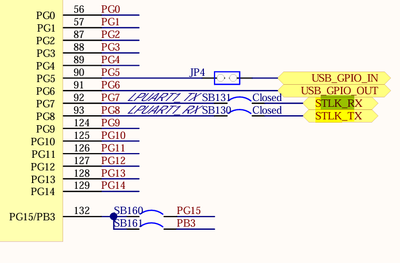

2025-09-21 2:04 AM
Maybe better is open schematic and no to shoot blindy.
Then use only LPUART1 for testing... And sorry but your bare metal tests "basic" is absurd
2025-09-21 2:17 AM - last edited on 2025-10-01 8:11 AM by Andrew Neil
Thank you for your response. I looked at the schematic and tried the LPUART1. I checked that the solder bridge is closed on the board as well, but it is still not working. I understand that the bare metal coding is not the best, and I first tried using the standard setup on STMCubeIDE and coding with the HAL libraries, but couldn't get anything to work (not even an LED to flash). That is why I resorted to bare metal coding because I have been able to directly get the pins to work through this, but have not been successful with UART communication. Any suggestions on why the LPUART isn't working? I have included my full code, which I used to test this, below.
