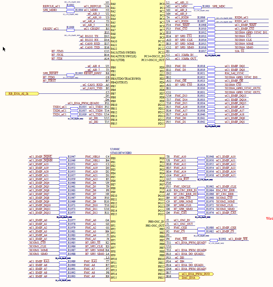

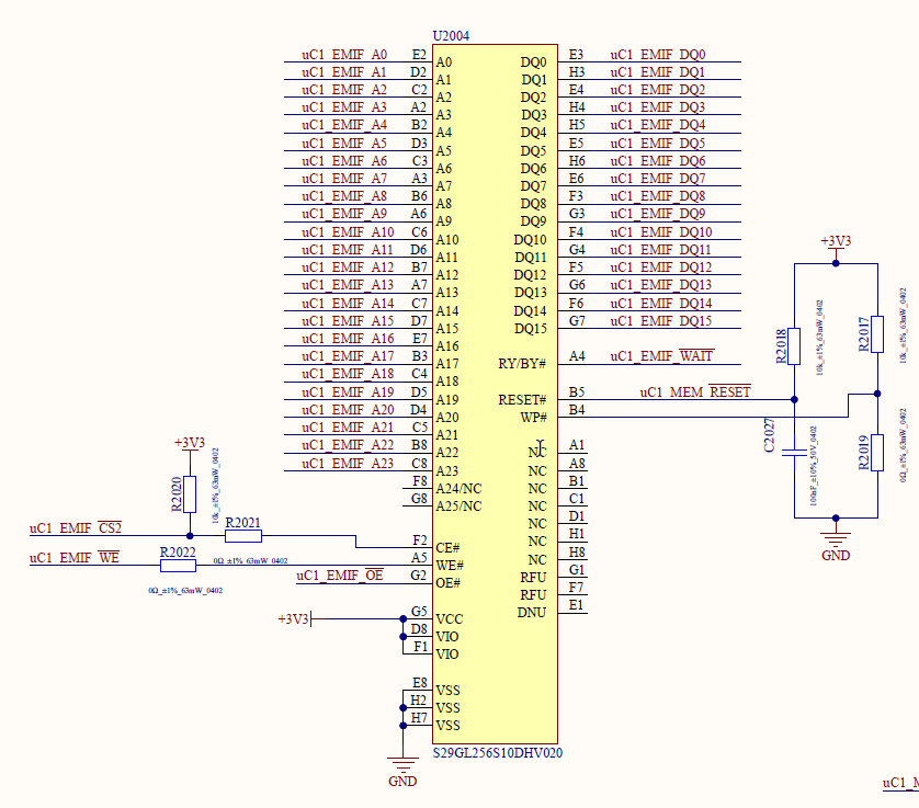

the issue is about a custom board with an STM32H45 and an S29GL256S paralel NOR flash

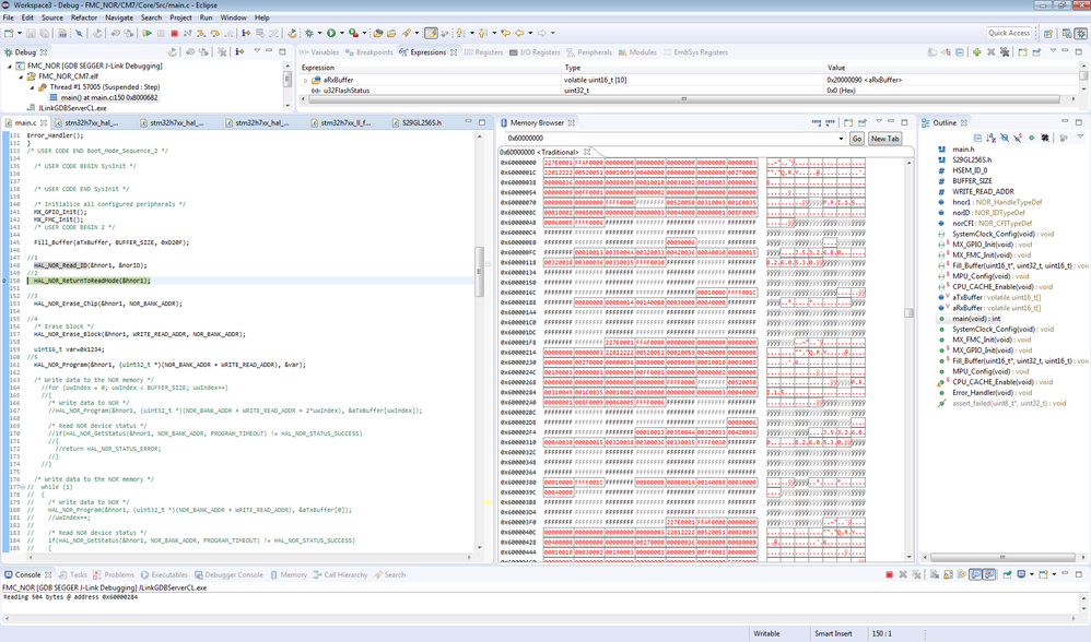

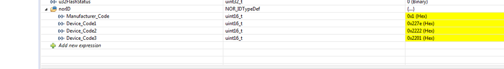

After FMC is initialized by the CM7 core as in the attached files, i am able to read the NOR flash ID,
but writing data to the IC does not work, memory browser shows only 0xFF, and when reading back, i get the same - only 0xFF.
I need to mention that the WE line was moved from the PH5 to PD5, and placed a pullup resistor to the RY/BY line.

Remember the NOR chip doesn't understand the STM32's address space, the chip has zero based addressing.
https://www.cypress.com/file/177976/download

HAL_NOR_Read_ID(&hnor1, &norID);
memory browser shows like in screenshot after reading the ID
