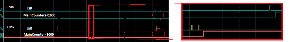

Result with IOs, because debugger might (and does) interfere.
So the ISR is called everytime, but MainCounter is not reset everytime. The behaviour is different with or without debugger connected, and also changes with different optimizations levels.
I'm starting to dislike this MCU, it's not like this is the only problem I have (1,2)
