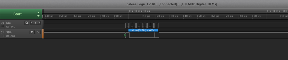

2021-02-03 1:20 AM
Also, I am only sending the first byte
