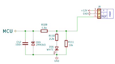

On my board both PIN9 and PIN97 have the following input circuit:

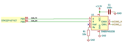

Additionally, although not used in this test project, the board also supports CAN communication thanks to the following circuit:
For testing, another ECU cyclically sends 8 CAN messages (DLC 8, extended ID):

On the input pin I generate a 0–12 V square signal (verified with an oscilloscope), and I monitor counter_1 and counter_2 using STM32CubeMonitor.

counter_1 (PIN 9 - PC15): Increases more than expected only when ST-Link is connected and CubeMonitor is running. Disconnecting ST-Link restores the expected behavior. CAN traffic has no influence.
counter_2 (PIN97 - PE0): Increases more than expected only when CAN messages are being sent. Stopping CAN traffic restores the expected behavior. ST-Link connection has no influence.

Sounds like coupling between CAN/pin97 resulting in pulses/spikes at pin 97, something similar with pin 9 too.
Sometimes the coupling is capacitive, but often these problems are related to board layout, particularly, also too often, to ground arrangement and currents flowing through ground (sometimes also supplies). Note, that EXTI is asynchronous, i.e. it reacts to very short (nanoseconds) pulses regardless of the system clock.
There's no point in measuring the 12V input. With very good oscilloscope probe and fast oscilloscope you can attempt to measure *directly* at the pin in question, with ground connected through a very short pigtail to the nearest VSS pin of the mcu; however, I repeat, we are talking single-digit nanoseconds here.
Generally, EXTI is better to be avoided. Use either timer inputs, which are synchronous and have an optional digital filter; or, as your input signals appear to be changing in the timeframe of seconds, simply sample the inputs in a periodical interrupt (e.g. 10-100ms, whatever is suitable).

> the unexpected increments occur only when the input signal is oscillating.
My guess is, that the input signal has a long rise/fall time, and the interference from STLink has a relatively small amplitude (so in itself it won't cross the input threshold), but is superimposed at that input signal, and when that reaches the vicinity of the input threshold, that superimposed "noise" results in a bunch of rapid EXTI interrupts.
The change you've made in the code effectively filters out shorter pulses; however, "shorter" here depends on the interrupt latency (including the Cube/HAL code, which may be significantly long).
I maintain what I wrote above.
