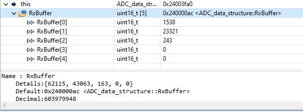

Data within the buffer once Transfer Completed flag 4 from the DMA1 is triggered. Just pure nonsense data. The pins are pull down and not in used but here there's some kind of voltage.

data seen in buffer, this shows ADC_DR => buffer should work. it is suggested to simplify the project, for example, to convert one channel only per time. for LL_ADC_CHANNEL_TEMPSENSOR, I see 625~630mV at room temperature. for LL_ADC_CHANNEL_VREFINT, I see 1221~1224mV.
Yup, just converted the ADC3 to a 1 channel scan with the temperature sensor enabled only. I am seeing now 0.0076539251V on the channel
equation used (ADC->DR)/(2^16-1/3.3). Is this normal operation?
@jiangfan​ Figured out the issue but not the solution yet. Its the DMA transferring the data. I see the data within the ADC-DR register correctly however when the data is transferred in to the array buffer its completely different.
For example ADC3->DR = 0x30B0, and in Buffer = 0xA5. No idea whats going on here
