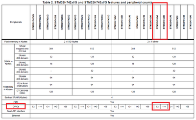

STM32H743VIT6 is 100 pin package while STM32H743ZIT6 is 144 pin package. So the only difference is the pin number / IOs:
Please refer to the datasheet Table 2 where the features of each part number are provided:

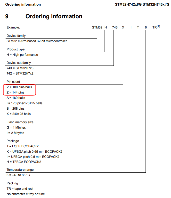

2024-04-09 2:47 AM
The datasheet also tells you what all those suffix characters mean in the part number:
