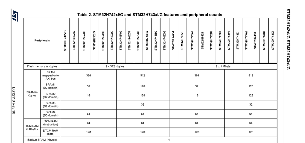

afaik is same chip, die .
Just some pins (100,144,..) used/bonded and memory test for 1M or 2MB , die always has 2MB.

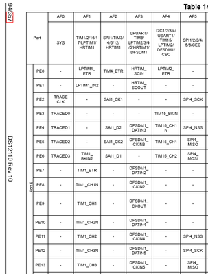

So i tried , on H743ZIT :
simple i/o loop , mosi -> miso (at 15Mbit) ; 2 bytes : AA ,  55 , HAL_SPI_TransmitReceive():
- first test on SPI4 : sending ok, receive 00 ;  hmmm....
- next test on SPI2: sending ok, receive ok ; ahaa...
- then both + print result:
	  HAL_SPI_TransmitReceive(&hspi2, (uint8_t *)TxData, (uint8_t *)RxData, 2, 20);
	  printf("Rx2 : %X , %X  \r\n" , RxData[0] , RxData[1]);
	  HAL_SPI_TransmitReceive(&hspi4, (uint8_t *)TxData, (uint8_t *)RxData, 2, 20);
	  printf("Rx4 : %X , %X  \r\n" , RxData[0] , RxData[1]);
- then check AF port/pin setting : seem ok, AF5 .
- then try moving the miso to other pin PE13 -> PE5 now.
- then:
>> So seems a chip problem ( or ds wrong about the AF mapping) :
AF5 on PE13 not switching to SPI4_miso.
conclusion :
SPI4 Rx is not switched to PE13 , when set to it; only zero data input, not level on pin.
SPI4 Rx is switched to PE5 , when set to it; Rx data as expected.
GreenGuy
Lead
So in your first trial, SPI4 MISO was set to PE13 and the received data was 0 regardless of the transmit data.
And in the second trial, SPI4 MISO was set to PE5 and the received data matched the transmitted data.
Do I have that correct?
Interesting, because In my design, I have SPI4 MISO set to PE5 since PE13 is being used by FMC.
Right, on PE5 miso gets input from pin, read data ok then.
So you can try remap on other pin - in your case ? (in my 144pin only PE5/13 possible)
check while debug, whats in SFR for GPIO port PE -> pin5 : should be 5 (=AF5)

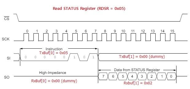

Please see the source code below.
uint8_t readStatusRegister()
    uint8_t TxBuf[2];
    uint8_t RxBuf[2];
    TxBuf[0] = 0x05; // RDSR Instruction
    TxBuf[1] = 0x00; // dummy
    HAL_SPI_TransmitReceive_IT(&hspi4, TxBuf, RxBuf, 2);
    // RxBuf[0] = 0x00; //dummy
    // RxBuf[1] = 0x02;
    return RxBuf[1];
Yes this is appropriate for the M95010-W EEPROM and is precisely how I applied it.
However, in my case the Data from the status register while visible on the scope did show up in RxBuff[1], but rather 0x00.  You may need to back track through the post to find the scope shot.  At least I hope it is still there.
