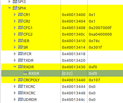

I checked the SPI4 RXDR and it contains the data the scope shows on the MISO line. This data is not making it to the buffer pointed to in the HAL_SPI_TransmitReceive call.

Further investigation: I cannot use the instance to see the Special Register for SPI4->RXDR. It shows 0 while the SFR's tab in the debugger shows:
So there is a disconnect there and I am not sure how the Instance structure gets updated.
