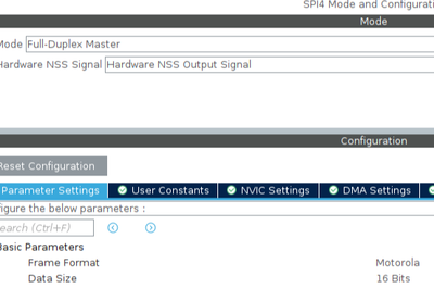

SPI4 configuration:

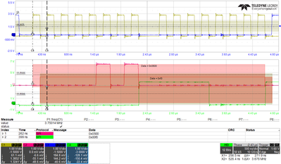

1) The NSS, SCLK, MOSI, and MISO lines all have the correct levels at the correct time communicating to a MX9050 EEPROM device attempting to read the status byte. The MOSI line contains 0x05 and the MISO line contains 0xF0 in response as read using a O'scope.

Here is the scope shot with the EEPROM mounted as probed at the EEPROM.
 I have verified that the MISO from the MCU to the EEPROM has good connectivity by configuring the MISO line in the MCU code with a pull-up and with a pull-down (2 different cases) and while the SPI4 is idle measure the MISO line at the EEPROM.  The measurement shows HIGH pulled-up case and LOW in the pulled-down case.  After removing the EEPROM and shorting the MOSI to MISO at the EEPROM location.  I repeated the the same cases and noted that inspecting the GPIOE, pins 5&6 show HIGH when pulled up and LOW when pulled down.
The connection is good.

What i not understand:
you state : SPI4 is setup as 8bit .
but on top you show: 16b
What now ?
in timing diagram i see clk + data send on mosi ;
so what coming on miso then ? (and dont forget, you read from a fifo, not a static register. This works only 1x , then data away. -> 0x0. )

That screen shot came from when I tried using 16 bit mode to see if there would be any difference.  Originally I had it set to 8bit.  Either way the result is the same.  Sorry for any confusion.

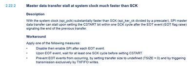

Just looked at the errata , spi ->
So just for fun : set prescaler 2 (lowest setting), give spi a slow (16M or 32M , what you need) clk from the pll divider, to see: changes this anything - or not.
btw
spi 1,2,3 have another clk source mux than spi 4,5 !  (i have clk for spi4 at 48M , also on spi2 prescaler 2)
