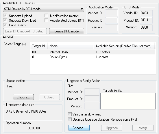

When launching DduSeDemo windows application, I got the confirmation to talk to the system bootloader which is in DFU mode (see available DFU devices on top):
Could verify these steps on your side ?
