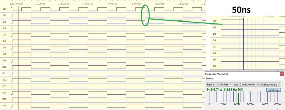

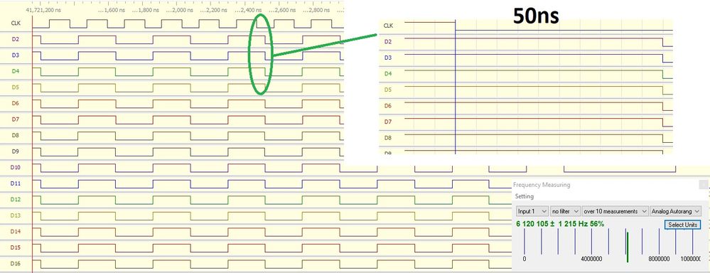

Hi all,
I make it work with BDMA and LPTIM2 and SRAM4, but here is 50ns offset between Clock (LPTIM2 PWM) and 16bit gpio.
As I mentioned before I need parallel synchronous transmission so I would like to eliminate 50ns offset between clock and data.
I trying to make synchronisation at falling edge of CLK. And my goal is reach 16MHz.
It is even possible with STM32H7 ?
Thank you
