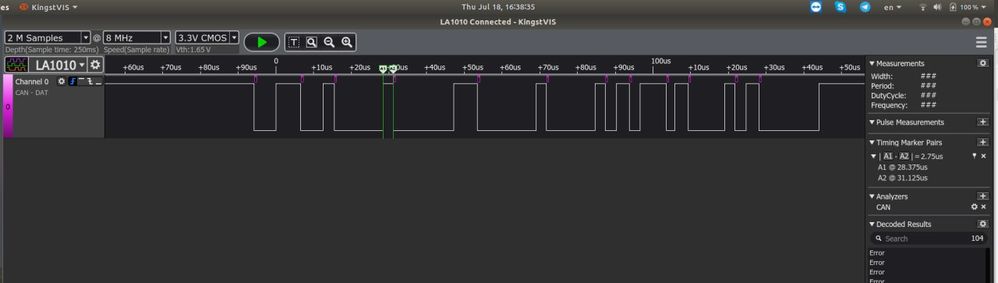

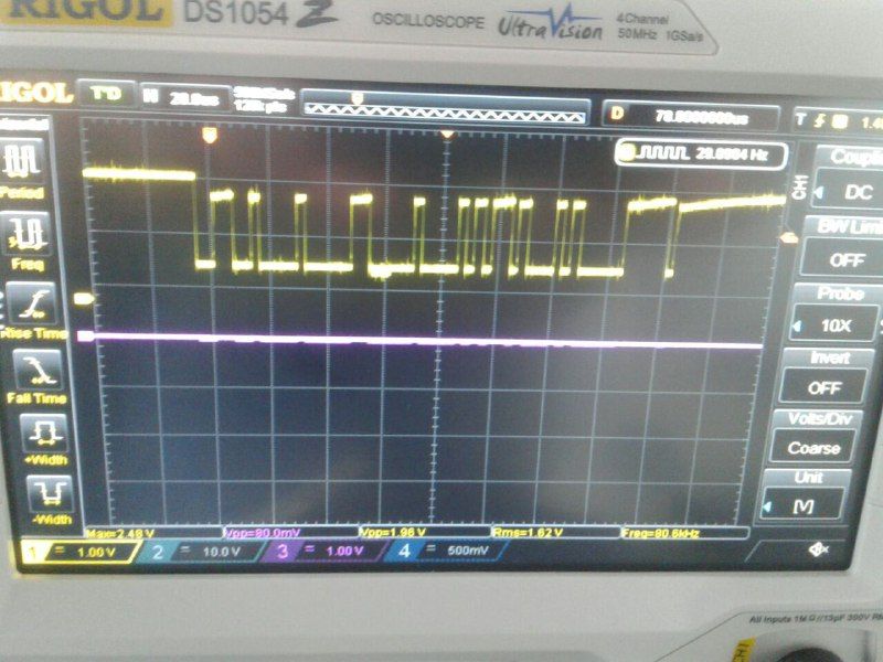

2019-07-18 9:54 AM
Unfortunately this example project doesn't work. In external loopback mode I can recieve data that I transive. but my logic analizer can't recognize that data as CAN communication and as a result device connected to this board can't recieve packet . Please see the pictures:
