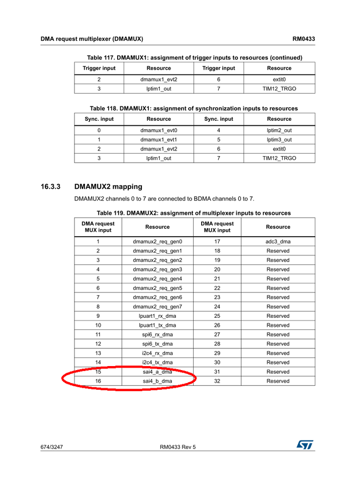

I am trying to program BDMA of STM32H743 using Nucleo board to perform DMA Peripheral to Memory operation .
What I have found a bit difficult is that I could not see any information on Reference Manual , Datasheet or on forum for the mapping information of basic DMA (BDMA) channels for SAI4 block A peripheral of STM32H7 MCU.
What I can see is the only Request ID mapping for DMAMUX2 which is 15 in this case.
Can anyone please help me to identify which channel should I use if I am trying to use SAI4_a BDMA?

2019-06-25 2:29 PM
And then it's you who says to which DMA channel will this request be directed, by setting the number of these requests to DMAMUX2_CxCR.DMAREQ_ID for the selected channel x.
Read the DMAMUX chapter in the RM.

Hi Jan,
Thanks for your response . Looking at the image you provided it only tells DMAMux2 input as 15 for Sai4_a but no mapping showed for input 15 to channel. It says DMAMux2 , channel 0 to 7 connected to BDMA channel 0 to 7.
Where is input 15 mapped to channel that bit is confusing as putting in on channel 1 seems to be working.

As I've said above, you map it in by setting a chosen DMAMUX2_CxCR.DMAREQ_ID to 15.
