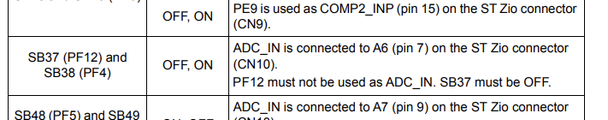

im using ADC1 ch6, according to the reference manual in order to use this output i had to change SB
so that SB37 is on and SB38 is off , if i did understand that correctly.
my output did not seem to mind the pin input and just constantly showed a random value that was between 8000 and 11000

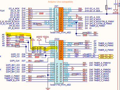

Download the schematic for your board and ensure the pin that CubeMX is using for the ADC channel is connected to the header where you are applying the voltage.

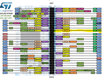

on the schematic "PF12" is connected to CN10 Pin7
on the Nucleo pinout doc "PF12" is connected to CN7 pin20
which is not making me need to recheck my entire layout.

ADC1 in6 is on pin PF12 , H743Z/144pin .
MB1364 has (when sb37 closed, 38 open) it on CN10, pin7 .
-> check, what MBxxx version you have ! and whats MBxxx from the other picture -- where you found this ?

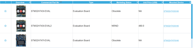

it appears i was looking at the ZI documentation which is Obsolette
instead of the ZI2 documentations...
thanks everyone :)
