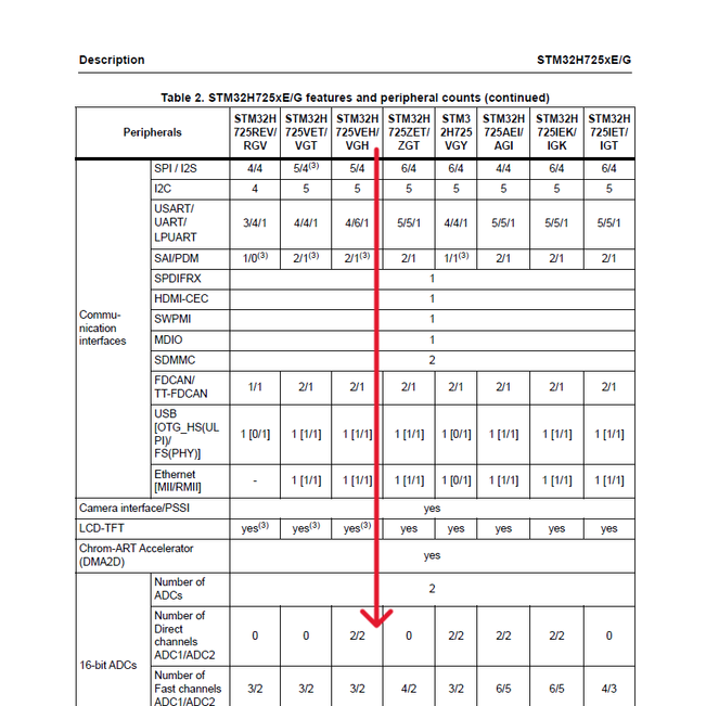

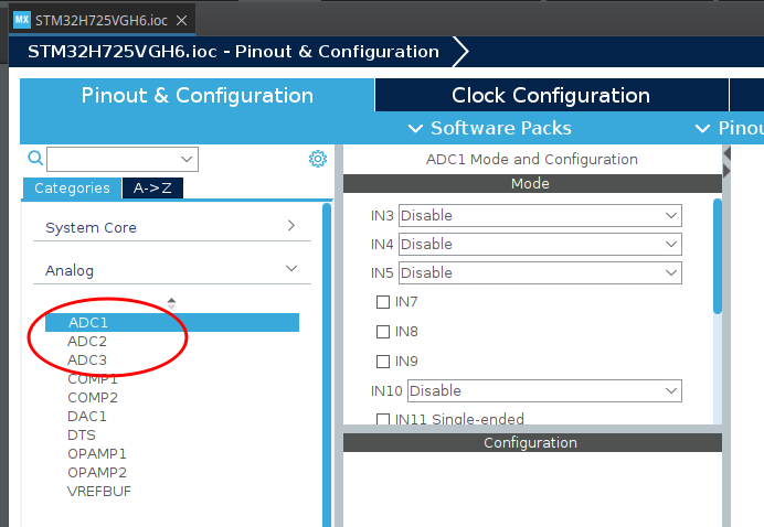

Hi! I am using STM32H725VGH6 series MCU, in the datasheet it is clearly mentioned that it has 2 direct 16bit ADC channels, while it is not there when trying to configure in STM32CubeIDE. Can you make sure the datasheet is correct or not?

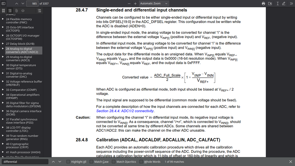

I want configure as differential (not single ended), interleaved mode using direct channel ADCs so that it can be achieved high sampling rate
I found this information, check if it's your case:
Caution: When configuring the channel “i” in differential input mode, its negative input voltage is connected to V INN[i]. As a consequence, channel “i+n”, which is connected to VINN[i] , should not be converted at same time by different ADCs. Some channels are shared between ADC1/ADC2: this can make the channel on the other ADC unusable.

Can you please go to my main question mentioned below-

Here I've attached a snapshot (datasheet STM32H725xE/G, page n. 20), mentioned number of direct channels ADC1/ADC2 is 2. Can you please confirm me the MCU pins (pin number/name which can be configured for these channels) for these channels?
