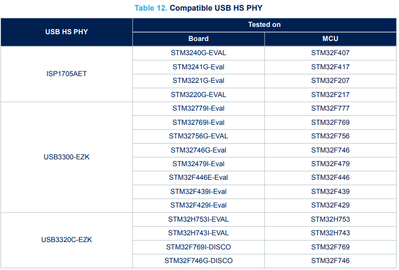

I am in process of developing a device with STM32H723(100pin) which must have USB HS device functionality.
I found a number of different HS ULPI PHY chips like USB330, USB3320C, FUSB2805MLX etc.
During searching info about this feature I found AN4879 ST Application Note which provides list of External USB HS PHYs compatible via ULPI interface for a number of STM32 microcontrollers:
But I couldn't find such info for STM32H723.
So, my question is: what External USB HS PHY is compatible with STM32H723?
Thank you!!!

Dear @MikeEmbedded ,
Welcome to our STM32 community and thank you for asking . Indeed H723 is same family as H7 and the ULPI Phy compatible with H75/4x are also . Our Application note need to be updated . Thank you for spotting it .
