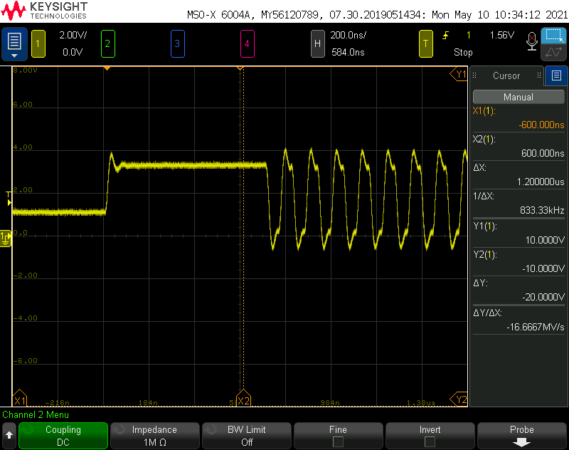

I am facing a very weird issue with PWM on my STM32H723.
I am generating a very fast PWM with TIM3 (TIMx_ARR = 10, TIMx_CCRx = 5, Timer Clk 275 MHz). However, the very first pulse is clearly way too long:
Does anyone have an Idea where this comes from?

Ah, nevermind, just found the reason. CH Polarity high is causing the channel to be set high before the PWM actually starts.
