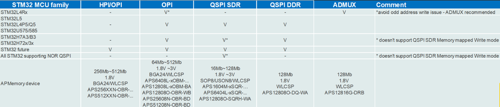

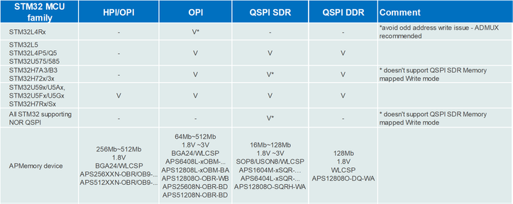

Just updating the STM32 - IoT RAM (QSPI, Octal and Hexa RAM) support overview
2024-04-17 11:22 AM
Updated AP Memory IoT RAM (QSPI, OPI & HPI PSRAM) overview with latest STM32 MCU
