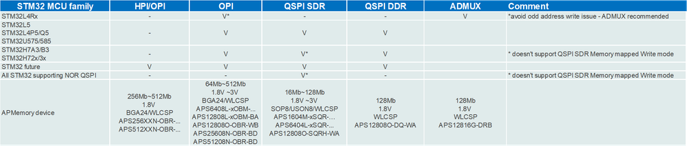

We have studied this case and concluded it's not possible to get full functionnality of STM32H7A (also H72x/3x) with QSPI SDR. But it works well with QSPI DDR (7pins, 128Mb in WLCSP) and OPI (11pins, 64Mb~512Mb BGA24/WLCSP). Other STM32 works well also with all device, including QSPI SDR (6 pins, 16Mb~128Mb, SOP8/USON/WLCSP).
Regards
Alex

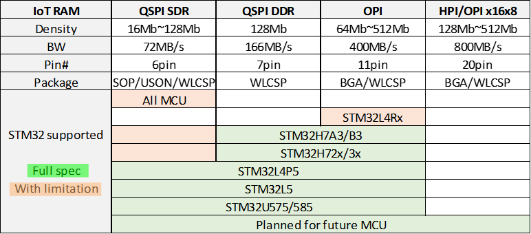

2022-03-30 3:01 PM
Here is an overview of STM32/APMemory IoT RAM device supported
covering HPI, OPI, QSPI SDR, QSPI SDR per STM32 family
Hope this help
For proto: https://www2.mouser.com/c/?m=AP%20Memory%20Technology
2022-03-30 3:17 PM
another way to show the data

From our understanding, STM32H723 doesn't support Memory mapped write for QSPI SDR (no issue for QSPI DDR and OPI)
Does the issue seen are only for Write or also Read ?
