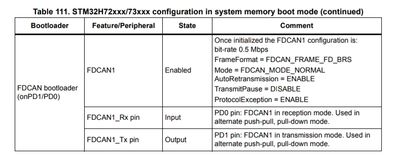

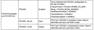

Have you verified that your configurations are compatible with configuration in system memory boot mode :
Best regards.
II
2023-09-08 3:14 AM
Thank you for bringing attention to this I've just checked PH13 /PH14 are not detailed in the datasheet. So, you need to configure PD0/PD1 instead. An internal ticket 161018 is submitted to update AN2606.
