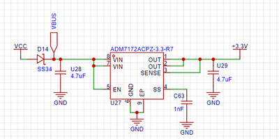

- Power section :

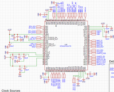

- Microcontroller (I'm sorry for this layout, I'll make it more readable in the near future) :

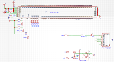

- eMMC memory and USB-C connector :
If you see some issues on the schematics please do not hesitate to let me know.

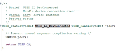

I found this function on the USBD driver that can maybe do the job:
Do you know if there's a basic implementation of this function for what I'm trying to do ?

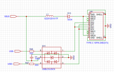

2024-08-19 6:09 AM
> Are the electronics schematics showed above good for what i'm doing?
> How can i switch between this 2 modes by detecting a connection via USB?
This is typically done by sensing the VBUS voltage. When it's present, the USB connection is present. You can put a resistor divider from this voltage to an ADC pin to measure the actual voltage, or you can read it with a digital pin for an on/off indication.

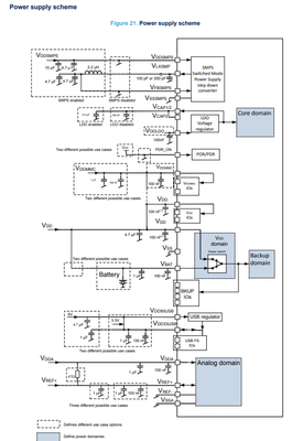

Thank you for the fast response!! For the electronics I'm looking at the microcontroller datasheet, especially this page here :
And that's why I used a 100nF capacitor for VCAPs :

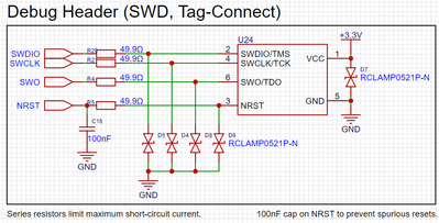

The NRST pin already have a decoupling capacitor here (didn't show that before sorry) :

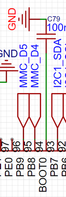

For BOOT0, it's already pulled to ground isn't it?

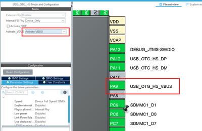

So, based on what you've said, if I activate the VBUS on CubeIDE as follows :

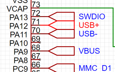

And on my schematics, connect the VBUS of the USB :
To the new available VBUS pin of the STM32H7 :
I should be able to know whenever a USB connection with my PC is made right ?

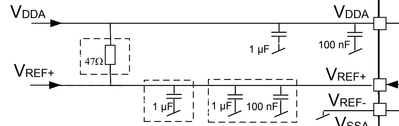

Dang, I just saw that.. Thank you for pointing the issue, I just tried to follow the datasheet :
But it seems very confusing. Do you know how can I solve it ?
Is LDO disabled for your layout? This means you need to supply the VCAP voltage yourself, which I don't see in the schematic.
That's a capacitor, not a resistor. There will be some leakage, but I would not rely on that to pull down the pin. In any case, having a capacitor instead of a resistor here makes very little sense to me.
The USB is correct in theory, but you may want to put it as a GPIO. Not sure how well integrated VBUS detection is in the USB software stack.
2024-08-19 7:16 AM
Oh I didn't know that. I just assumed it was a functionnality that I didn't need. Made the change and switched to 2.2uF capacitors!
That's so *** of me, you're totally right. An attention error, I'll change it right away, thanks!
I see, I'll put it as GPIO and use it as voltage detector. Do you think that i can connect it "as is" or do i have to add extra passive components?

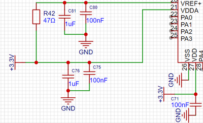

2024-08-19 7:36 AM
As mentioned - feed VDDA by 3.3V directly and just connect the 47ohms from VDDA to VREF+, and keep the caps on both sides of the resistor.
2024-08-19 7:48 AM
I see now :
Looks better now!
2024-08-19 8:00 AM
I would put a resistor divider so the voltage is max 3.3V when USB is connected. 5V can be safe, but you would need to verify the pin can handle it. Most can.
