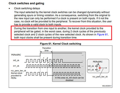

Most probably this is due to this behavior (from RM0433) :
Try to switch the clock source from PCLK2 (clock source of the BL) to PLLQ2 before jumping to the application.

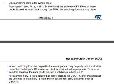

2024-12-23 1:52 AM - edited 2024-12-23 1:59 AM

Hey @mƎALLEm,
this is it, thanks a lot for your reply. But this is a very dangerous dependency, right? Meaning that we have to provide on any used peripheral (UARTS in this case) all clock sources in the bootloader, just to ensure that we can get out of this if a malicious firmware used a different clock source.
Is this the same for other peripherals like Quadspi or so?
Best regards,
Eric
2024-12-23 3:33 AM
This is related to RCC not to the peripherals.
So you need to take care of that behavior when switching from clock source to another no matter the peripheral is.

Hey @mƎALLEm,
okay that’s for the hint. I found the section you showed above. So we have to verify that all peripherals used in the boot loader get any clock source. Just to provide always the possibility to recover from it if the application, for whatever reason, switched to a different clocksource. In the BL we did not activate the PLL2, that’s why we get stuck.
Just imagine the application enables, due to firmware issue CSI or LSE, we would have to provide it in the bootloader to avoid that we are stuck.
I still find it very dangerous but now we know how to deal with it.
