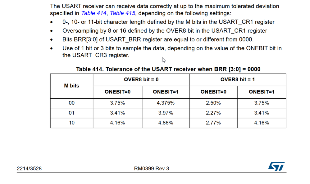

Uart's receive abilities relate to the clock deviation: see RM0399 reference manual.
Your uart clock is generated throug a PLL, is your PLL operating within its frequency spec (see my post of yesterday). If not it can be unstable. (If are you using MX configurator, then illegal configurations turn red).
