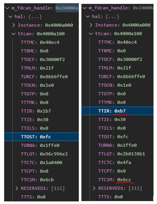

The first thought I had was that the error was due to problems with the delay compensation, since Rx was now being connected internally to Tx. So I tried reducing the delay compensation values and disabling it completely. This did have the effect of TTCSM now equaling 0x6cb like the working unit. But no change in the error behavior.
HAL_FDCAN_EnableTxDelayCompensation(&handle->hal);
HAL_FDCAN_ConfigTxDelayCompensation(&handle->hal, delay_offset, delay_filter);
