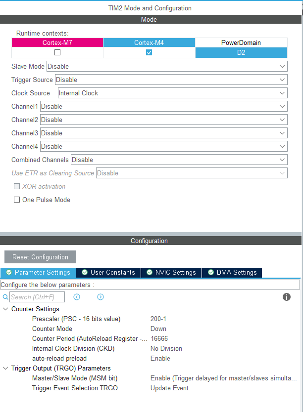

I'm using STM32H755 Nucleo board and I'm trying to use TIM2 to trigger Dual ADC conversion. M7 core is running FREERTOS and M4 is bare metal. ADC is controlled by M4 core. DMA is used to transfer data to M7 and then M7 is using ethernet to transfer data further. Sampling rate of my ADC is 1.92MSPS (12bit). I try to use TIM2 to trigger ADC. This should happen with rate of 60Hz. Every 16.67ms (60Hz), I would like to collect 2x2048 samples.

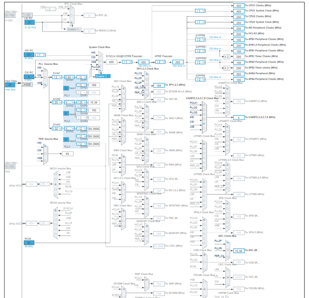

For some reason my TIM2 interrupt occurs every 52ms. It sounds like my clock rate is not 200MHz as shown in .ioc, but it is 64MHz. What might explain the problem?

That would match with 52ms vs 16.67ms, but according to my understanding my clock source is 25MHz HSE and APB1 timer clock is 200MHz.

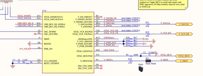

see circuit:
so clock from st-link: 8M . (not 25M, or 25/3 ~ 8.33M , depends on st-linkV3 setting on update)

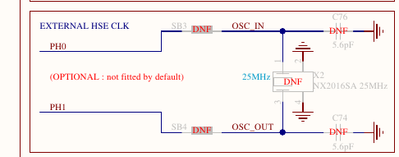

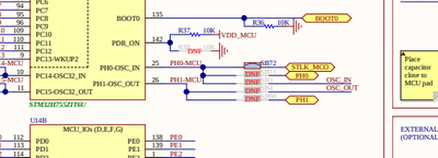

Sure - if you connect a 25M crystal. Look at your board: what is fitted or empty places :
So if nothing there, but you want it - you have to put the missing parts to the board and
-> SB72 off , SB3+4 ON ; add X2 , C74, 76 ; 25MHz + 2 x 5.6 pF .
