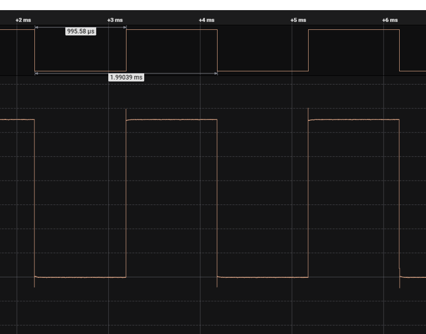

I then toggle a GPIO pin with the timer interrupt function and measure this on my logic analyzer - what I find is that the pin is toggling about 5us too fast. Any idea to why this could be? I suppose I could tune the counter period until I get the desired result but I feel uneasy not being able to predict the frequency more accurately. Thanks a lot for any input

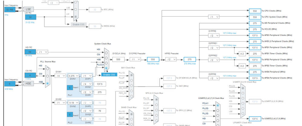

Thanks for the reply. I am using HSE at 8MHz through PLLCLK generating a system clock at 550 MHz and 275 MHz for the timers. Please see the attached screen shot.

2022-08-04 7:58 AM
Try disable CSS and calculate from your crystal ppm possible PLL errors.+ -

2022-08-04 8:11 AM
What's the 8MHz clock source, a crystal, or STLinkV3 MCO?
2022-08-04 9:13 AM
This does indeed seem to apply to me as I am using a Nucleo dev board.. Thanks for sharing!
I am however not sure about what they mean when they speak of this 'partial workaround' - how do I change the MCO to this 25/3 MHz mode and how do I make my STM32 understand that it should not use its HSI?
Oskar
2022-08-04 9:24 AM
2022-08-05 2:25 AM
That's exactly what I needed, things are working perfectly now! Amazing how quickly you could sort that out for me, thanks a lot
