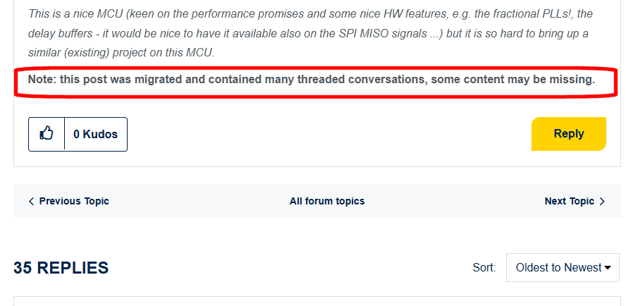

2024-10-30 10:47 AM
@AG70 Did you see the footnote at the bottom of the Opening Post:
It seems that "content may be missing" is known to include "links may be broken":
https://community.st.com/t5/feedback-forum/broken-forum-links/m-p/631746
