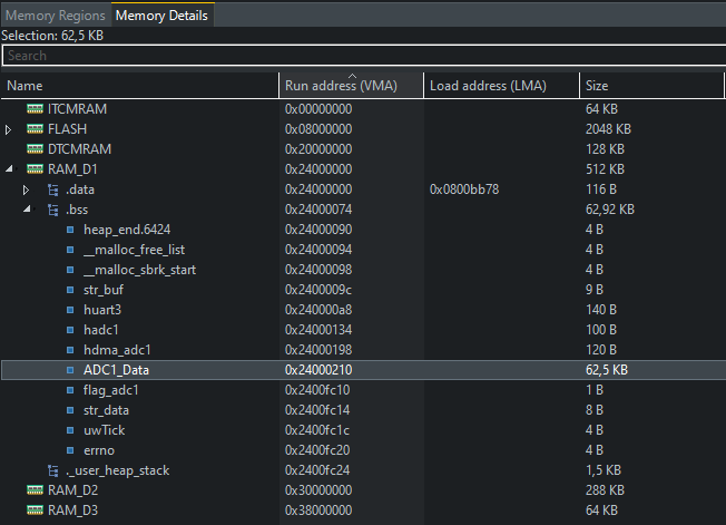

Hello there! Thanks a lot for your solution. It is very helpful. I had the same problem.
But I made only one change:
hadc1.Init.ConversionDataManagement = ADC_CONVERSIONDATA_DR;
to
hadc1.Init.ConversionDataManagement = ADC_CONVERSIONDATA_DMA_CIRCULAR;
I didn't made any changes with linker Script.
In according to screenshot below my variable ADC1_Data[ADC_BUFFER_SIZE] located in D1 domian section:
And all works fine :ok_hand:
