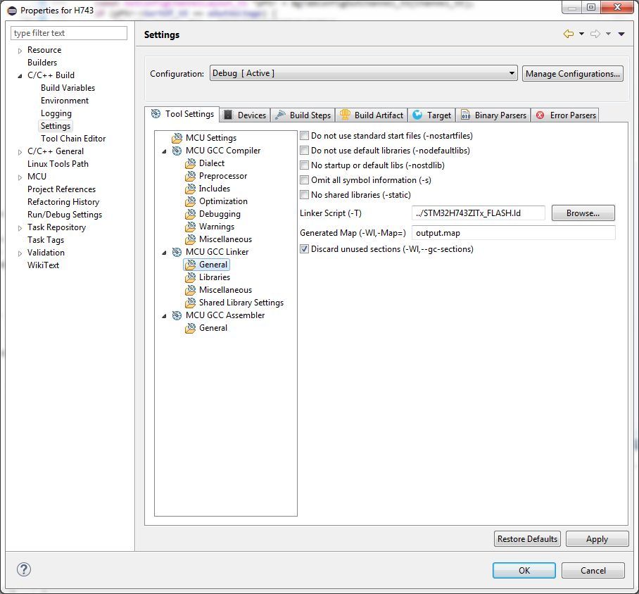

Depending on your project structure, search for the *.ld extention.
You can define different scripts for Debug|Release
in my poject:
W:\Proj_H743\H743\STM32H743ZITx_FLASH.ld

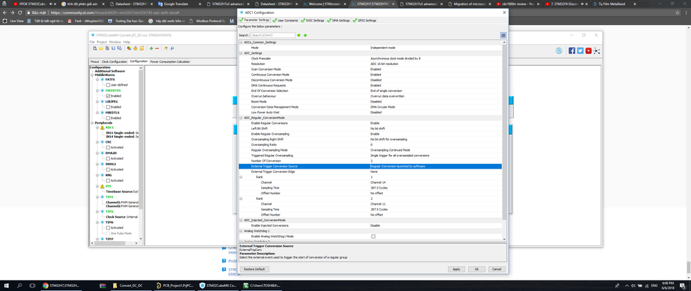

Thank for your replay. I use Keil 5 to complie, My project is read multi channels ADC, but I can't use DMA for ADC. If you know it, please help me!  I use stm32H743VI6 and variables adc_value not change...0690X0000060L9GQAU.png0690X0000060L9LQAU.png

Created by cube-x and edited by myself for my purpose.

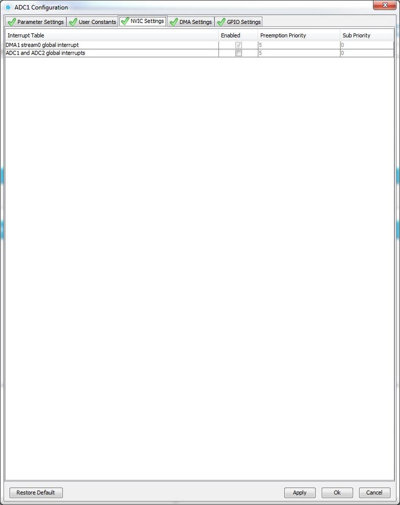

Posted on June 07, 2018 at 15:15
Hi Nhan,

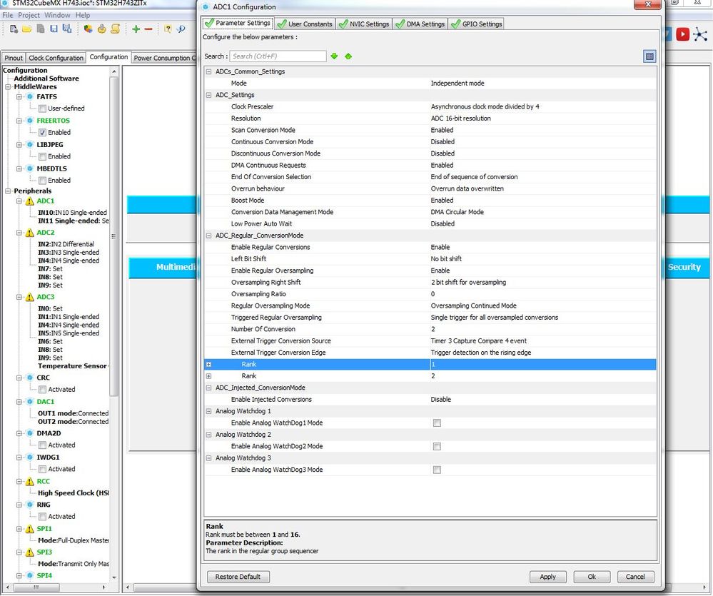

My setting for ADC1, of cause I am using also ADC2 and ADC3 (looks nearly same)
Difference to your app:
ADC1 is triggered by Timer3 Capture. In your example you want to trigger by SW.

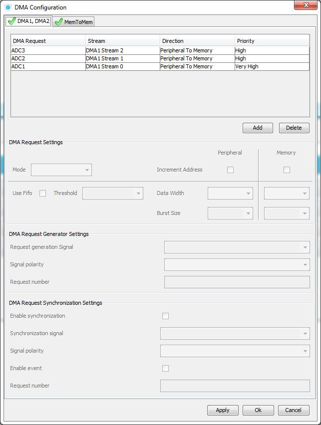

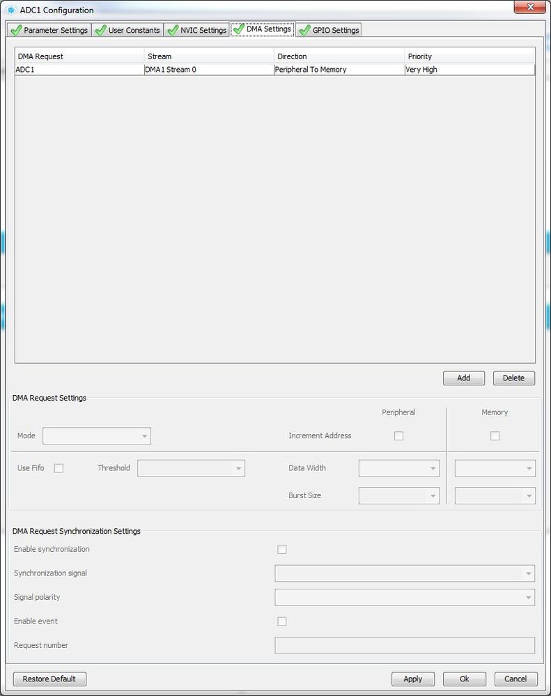

DMA definition for all ADC DMA channels
Hope this helps.
