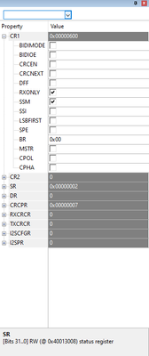

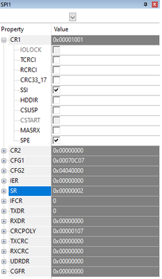

So i have a hard time to make spi of stm32h743 work as same as stm32f407's spi
line where we are waiting before catch the data in stm32f4 is while (!(hspi1.Instance->SR & SPI_FLAG_RXNE))
and in stm32h743: while (!(hspi1.Instance->SR & SPI_FLAG_RXP)) the flag names are diffrent but i gues its ok. here is imahge of initialized registers of noth mcus in the debug mode.
STM32f407:
STM32H743:
as you can see stm32h7 has a lot if registers i didnt met before like FIFO and CSUPS etc... and lack of crucial registers as RXONLY.
f4 working fine, while h7 have around 4-6(rxcounter equls 4-6 and then it just hangs) interaction with:

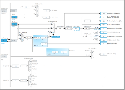

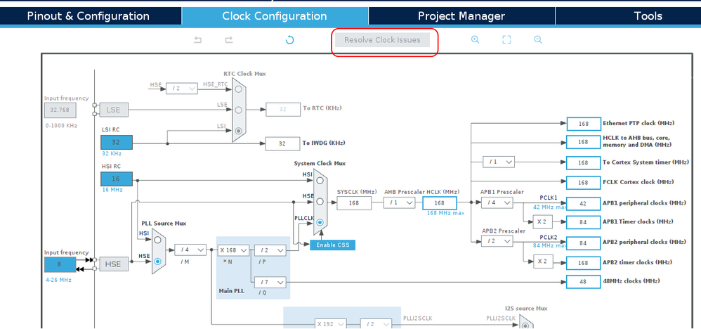

I have tried a lot to make it work, seems like nothing working. I started to think that the problem with clock freq, can it be so?

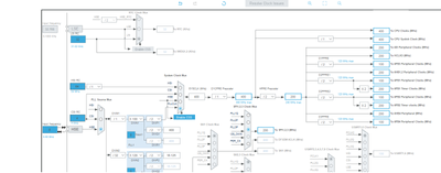

here is clock configuration of STMH743:
here is clock configuration of STMf407:
as you can see stmf4 has a higher clock, can it be the issue?

2023-07-26 9:41 PM
I have a project with F407 and I also thought about migrating to H743, but to solve USB Host issues. If you are using a baremetal code form, it may be interesting to generate the HAL code, and open the HAL functions to find out how registers are handled, most users will use HAL.
About the clock, where is the label "480 MHz Max" put the desired clock, try clicking on the "Resolve" button

2023-07-26 11:42 PM - edited 2023-07-26 11:44 PM
Thanks for yoir answe @AScha.3 i understand, but we cant see at what clock spi in f4 running, but it has 168Mhz compared to 96mhz of h7, so didnt it mean that spi clock of h7 lower aswell? Im afraid that slave spi not to fast to catch the master or maybe the problem isnt in clock at all, i really need help to solve this
2023-07-26 11:45 PM - edited 2023-07-26 11:59 PM
the whole spi code generated by cubemx, also my crystal on the board is 8mhz, so i cant choose higher.When i tried to configurated with 8mhz it seems like its almost impossilbe to make usb and spi higher that in the image. The funny thing is that on f4 i have 8mhz crystal as well and it somehow managed to run at 168mhz

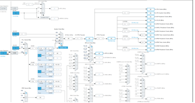

2023-07-27 12:47 AM - edited 2023-07-27 12:50 AM
so try H7 on higher core speed !
set divm1 to 8 and divn1 in PLL1 to...what you want, try 400 . -> 200Mhz core
+ need to set RCC , see:

2023-08-02 1:49 PM
thank you for your response mate, and sorry for my delayed answer, I have configured d my clock with 400mhz:
and trying to catch data with HAL:
