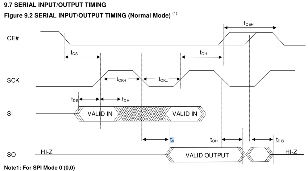

The meaning of tv is explained here:
This means that data on SO is valid after tv after the falling clock edge has been detected. Here only 1 read is shown here but I guess that all subsequent data reads are affected by the same tv.

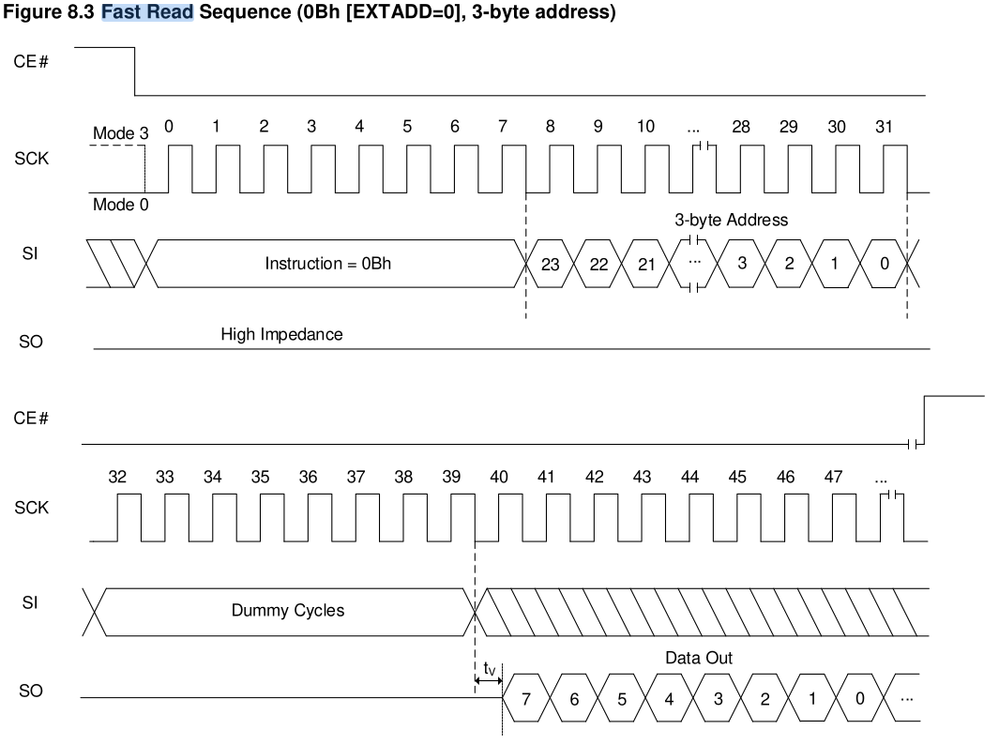

Looking at the following timing of the FAST READ, it seems that tv does only come into play once, after the dummy bytes sent and the first data bit read.
Usually, in mode 0, data is shifted at falling edge and sampled at rising edge. Here it looks that this is only the case for the first data bit. For all subsequent bits the timing suggests that data is shifted at rising and sampled at falling edge.

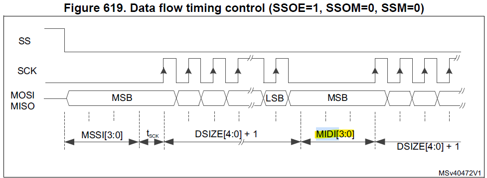

Hi @TDK ,
the STM32H7 SPI can insert extra clock cycles after each data frame using the MIDI parameter:
Inserting a dummy cycle after each single bit would delay the MCU sample point, just what I needed to run this device at 50Mbit/s with SPI Clock at 100MHz. But unfortunately the data frame size can be only be configured to 4...32 bit.
