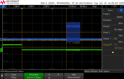

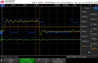

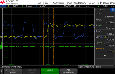

This is regarding the the problem after recent development from 18MHz to 22.8 MHz of operational speed of STM as slave operating with DMA transfer and SPI mode 01. Although the data sheet suggest maximum achievable speed of 31 MHz - I made it up to 22.8 MHz, beyond which data corruption occurs. As per my recent findings there is a persistent lag between the SCK and MISO signal around 8.8 -10.4 ns. I tested the SPI communication with and without hardware NSS, also with only SPI communication shutting of other operations but this delay is still there. Please find the oscilloscope readings for the reference.tsu (NSS)
tv(SO)
tw(SCKH)
th(SO)
In oscilloscope readings GREEN is NSS (CS), BLUE is SCK(Clock) and YELLOW is MISO signal.

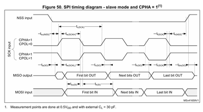

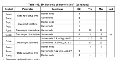

Further checking into the data sheet I found the following information:

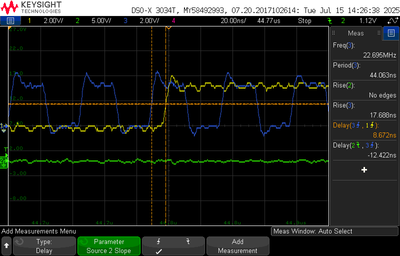

Comparing the oscilloscope readings with the data sheet information it feels like this lag (tv(SO)) is hardware limitation and can't be decreased. And at higher frequency this delay takes maximum of the clock signal duration thus giving a bit shift of 1 digit i.e 00111101 00010111 is recorded as 00011110 10001011, which corrupts the data received.

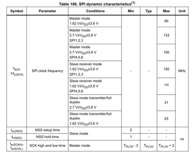

Is there any possible way to make it work at 31 MHz. I am using SPI5 with DMA as slave. Also 2 max speeds are mentioned for slave mode in the table - which I don't get, is it for any specific SPI or what does it mean?

Since the ST is the slave the timing specification Tv(SO) is fixed as you found observed. Worst case is 16nsec, which should be the criteria used when designing for the master device. You are reading a typical of 8-10nsec which starts to fail at the 22MHz range but I would design for the possibility of 16nsec.
So what I would like to see is what the master device timing looks like to be able to tell what max frequency between these two devices can be. It takes two to communicate and while the ST can push 31MHz as slave, if the master can not operate with the Tv(SO) given then you are forced to operate at a lower speed.
Possibilities are to make changes to either the master or slave if needing the higher speeds.
The second question was about the two listings in the chart. The Vdd can be variable for I/O and if it is higher, above 2.7V, you get a faster I/O as shown in the chart. Again the Vdd must be in spec for both the ST Slave and the master devices. Here's a spec:
You will have to check the schematic for what Vdd your setup is using.

Regarding two max speed,
Last line should be 1.62 V≤VDD≤2.7 V. Lower voltage range, lower speed, logically. Strange things, already DS Rev.9 and nobody notices.
I had an issue with bit shifting in one of my project on H743zi2 , spi in slave mode with baudrate >30 MHz, than I switched spi to TI_Mode. Try.
