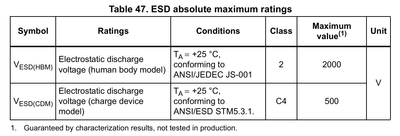

If you want more ESD protection that the chip already provides, you can add additional ESD diodes:
