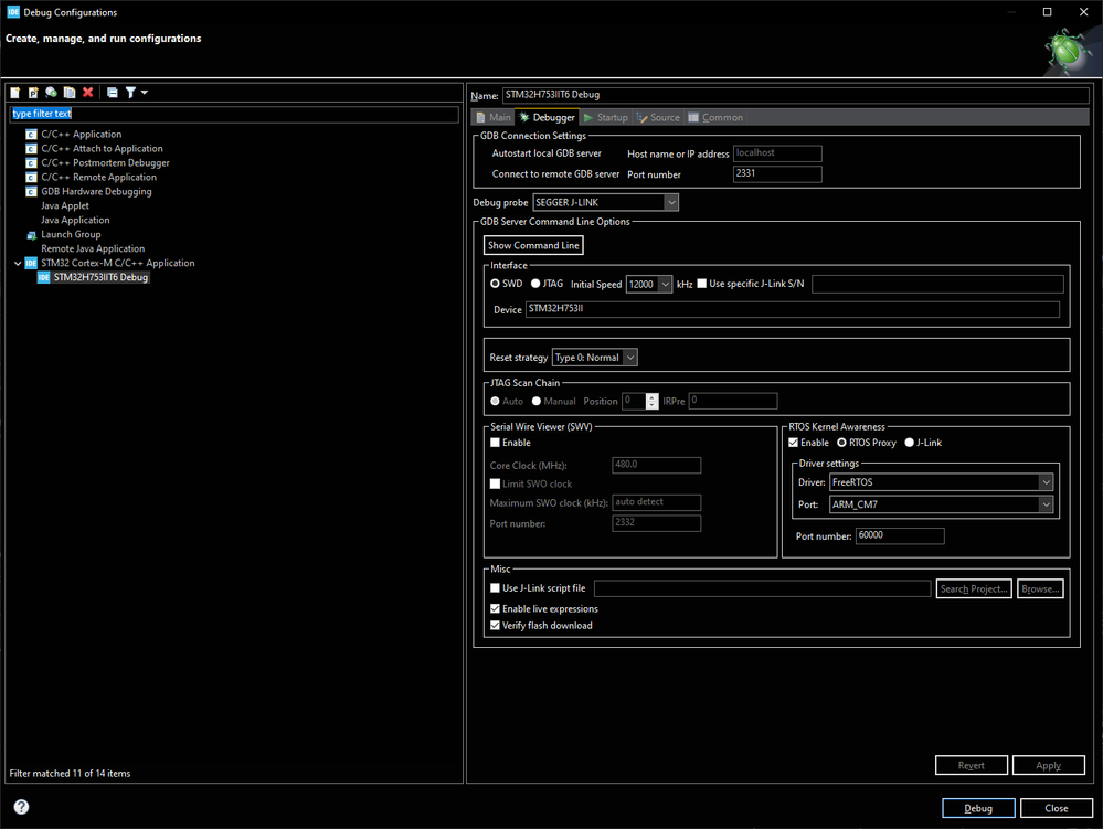

When trying to do a debug session onto these different STM32H7 devices:
we are receiving the error
with the following console statements:

Shutting down...We are able to connect most of the time, but there are times when we have to re-start the debugger 5+ times of getting this error before it will finally attach. We have tried a Segger J-Link Base / Plus / Pro and all exhibit the same issue. We have also tried different programming speeds (console captured w/ 12000khz)
Is this an issue on Segger's side, or is this an issue with STM32CubeIDE trying to verify the ID of the STM?

Yes, and it connects just fine every time using Segger J-Link Flash / GDB Server... however, if used in conjunction with STM32CubeIDE, the IDE cannot always connect (Sometimes it will, sometimes not)
2022-07-06 6:10 AM
IIRC this issue was already mentioned here. CubeIDE does not work well with some J-LINKs or some firmware versions, or only with certain MCUs ?
2022-07-06 6:23 AM
Maybe worth trying with Segger's Ozone debugger, then?
https://www.segger.com/products/development-tools/ozone-j-link-debugger/
I can confirm that it works with executables built by STM32CubeIDE.
2022-07-06 6:24 AM
Might also be worth checking on the Segger forums
2022-07-06 6:37 AM
Thanks for the info on Ozone. I have installed and it seems to work... however it is not as feature-rich as STM32CubeIDE.
But, since it does work just fine in Ozone, i believe that may point my original issue back to STM32CubeIDE as the main issue?
