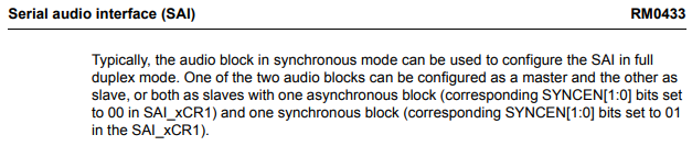

In the STM32H7 ref manual (RM0433 - Section 51.4.4), the following is said about configuring an SAI block in synchronous mode with the other SAI block in the same SAI peripheral
I'm confused about the following statements:
What is meant by full duplex mode above?
Option A makes sense to me, but for option B, is it valid for a slave block to be Asynchronous ?

Full duplex means that one block within on1 SAI is transmitter, the other receiver (e.g. for a stereo codec).
I also don't get the meaning of that RM excerpt.
