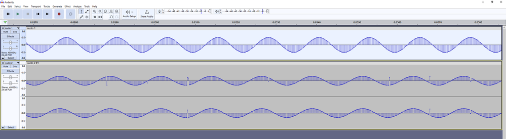

Audio from all other SAI sub-blocks has glitches as shown below.
Audio 1 - Source signal
Audio 2 - Output from SAI2B

I switched over to using double buffer mode, but I was still seeing glitches happening on the boundary of the DMA buffer.
For example, if my DMA buffer size is 96 samples, I would see glitches at multiples of 96 samples.
However, I seem to have found a magic DMA buffer size (64 samples) which does not cause any glitching.
(Each SAI sub-block uses 2 buffers of 64 samples each)
I can't come up with an explanation for this yet, keen to hear any thoughts on this.
