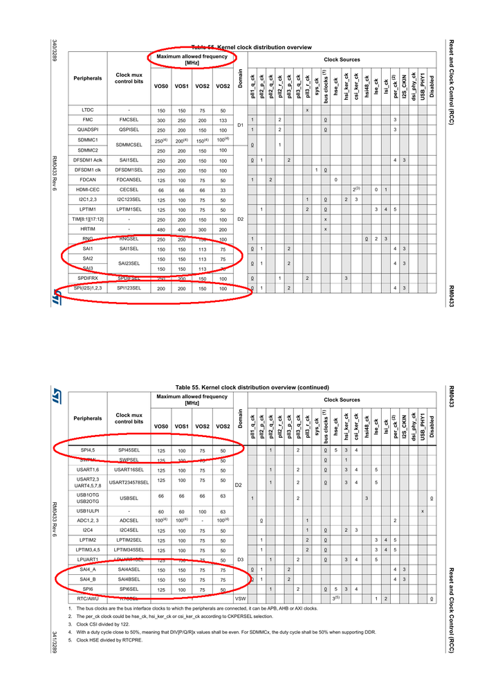

what is the maximum input clock for the SAIs and I2Ss for the H7 ?
I mean "sai_x_ker_ck" and "spi_ker_ck".
I couldn't find it in neither RM nor DS.
Is it dependent on some AHB / APB or D1/2/3 clock?
98.304 MHz is working (it is also in the RM's examples), even when abusing it to create a sample rate of 384 kHz.

There is no single 'H7, so you should check for your particular model.

2023-02-09 5:02 AM
Thanks!
I knew I had seen this before... but when searching the RM again and scrolling through the RCC chapter I oversaw these pages...
And yeah, I sometimes forget that the H7 models are quite different.
2023-02-09 6:21 AM
Great stuff, 400 kHz "audio" sampling rate with stereo 32 bit resolution no problem for the H723 at 400 MHz, using SAI1 and I2Sx!
