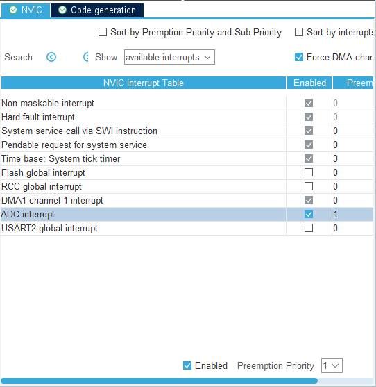

> I noticed that the ADC1_IRQHandler defined in the startup file is not implemeted in the code.
Enable that interrupt in the Chip Configruration (.ioc) Tool on the ADC NVIC Interrupt tab.

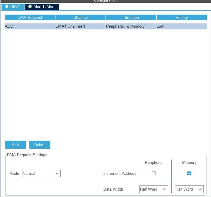

For the DMA: Have you enabled DMA in the Chip Configruration (.ioc) Tool?

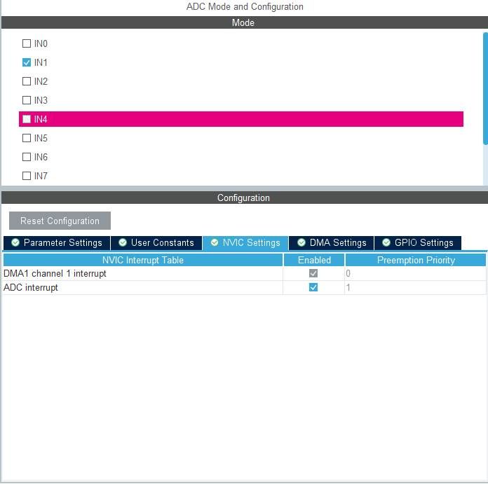

2023-02-09 4:46 AM
Thank oyu KnarfB,
I have enabled ADC NVIC and also DMA.
