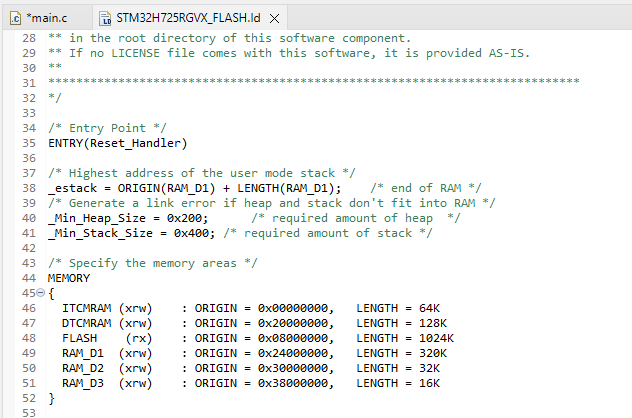

Open the linker script file STM32H725RGVX_FLASH.ld :
Then In your source code, Define a custom section: Start by defining a custom section using the __attribute__((section("section_name"))) attribute. For example :
uint8_t __attribute__((section(".RAM_D3"))) Tx_I2C[1];Foued
2023-05-31 1:04 AM
I checked both in the FLASH.ld and RAM.ld files and the RAM_D3 exists in both. I retested
uint8_t __attribute__((section(".RAM_D3"))) Tx_I2C[1];And still not working.

The easiest way may be to manage the memory yourself, e.g.:
uint8_t* ramd3 = 0x38000000;
now, as long as the linker doesn't put anything there, you can manage those 64K of ramd3 for yourself (I got the offset and size from the .ld file, so double check it there for your platform). To prevent the linker from placing stuff in there inadvertently, you could remove the RAM_D3 entry from the .ld file.
If instead you want to do it the proper way, using `__attribute((section.(..)))__` , you need to add a SECTION (hence the name) to the .ld file, e.g.: inside the existing SECTIONS block, add:
.ramd3 :
KEEP(*(.RAM_D3_SECTION))
} >RAM_D3Then you can declare your variables as
uint8_t __attribute__((section(".RAM_D3_SECTION"))) Tx_I2C[1];

The problem is the BDMA controller is only allowed to access the SRAM4 region. Using the default setup that would typically work on standard DMA will cause transmit errors, if you use the HAL_I2C_ErrorCallback() this is shown by the hi2c->ErrorCode returning (int)16 value, which in the stm32h7xx_hal_i2c.h translates to HAL_I2C_ERROR_DMA.
It also gives more specific details about the error type on the DMA through hi2c->hdmatx and hi2c->hdmarx. To fix it just move the global variables created for the BDMA to the SRAM4 region, as mentioned (sort of) in the article. Tod do this in STM32CubeIDE find the STM32H7A3ZITXQ_FLASH.ld and STM32H7A3ZITXQ_RAM.ld files, or whatever the FLASH.Id and RAM.Id files are called. In both files add:
.dma_buf (NOLOAD) :
. = ALIGN(4);
KEEP(*(.dma_buf))
. = ALIGN(4);
} >RAM_SRD
Ensure that the >RAM_SRD region described at the top of the files matches the BDMA SRAM region for the microcontroller, for stm32h7a3zi it will. Once added to both files, include the following definition in the file where the BDMA code is implemented:
#define DMA_BUFFER __attribute__((section(".dma_buf")))
Then declare all BDMA related global variables using the define, e.g: DMA_BUFFER uint8_t TxBuffer[32];
