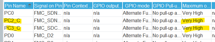

I used CubeMX for a design for H75x in LQFP176.
I was able to configure SDCKE0+SDNE0 signals of SDRAM Bank 1 to PC2_C and PC3_C.

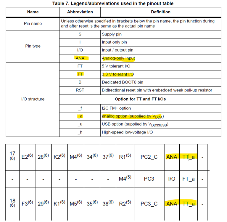

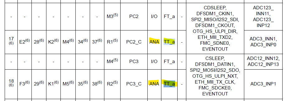

According to DS12117 Rev 9, the LQFP176 package has PC2_C and PC3_C pins only and the internal pads PC2 and PC3 are not routed to physical pins.

Seems that CubeMx isn't aware of this limitation.
Here you can configure Pxy_C pins for Ethernet, SPI, SDRAM, etc. and in all speed options including high speed.
IMHO the high speed option requires a drive strength >> 1mA.
I wonder if there is a chance that SDRAM works despite the 1mA limitiation.

In DS12117 rev9 Table 8 Pxy_C pins have attributes ANA and TT_a but I cannot find a documentation regarding these attributes. Second, is there any information from ST avaliable regarding "boundary scan capable pins"?

@regjoe wrote:Seems that CubeMx isn't aware of this limitation.
Seems to me this is an well-known but not fixed bug in CubeMx

2024-11-28 11:15 PM
Hello @ELABI.1
for me, disabling the "High Speed" option or showing an extra column with the pin type "ANA" or "TT_a", as shown in DS12117 rev9 Table 8, whatever this type name exactly means, could have saved one or another from a board redesign.
Thank you.

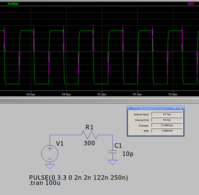

So i killed the tiny analog switch, that connects the pin here ! (1mA output load limit , afair.)
You can imagine these pins like a "normal" pin, with a very tiny resistor in series (about 300 ohms);
as long as you use the pin as input , no problem; as an output, at low speed and hi impedance load , no problem, as long as output current < 1 mA ; more load and its toasted .
So these pins might be used for SDRAM , if low capacitative load and low speed (maybe 4MHz).
I made simu, 300 ohms and 1mA -> 0,3mW max.
4MHz in 10pF load giving : 1mA rms , so its the limit.

I wonder why these pins can be configured as "High Speed" pins in CubeMx :(
