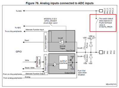

How did you configure the internal switches?
They need to be closed. So their respective values of PCXSO in SYSCFG_PMCR register needs to be 0.
+ Read this article: https://community.st.com/t5/stm32-mcus/faq-default-state-of-stm32h7-switches-connecting-pxy-c-and-pxy/ta-p/49300

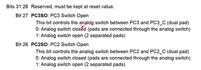

it seems i misled by the H755 user manual.
please check H755 rm0399, page 587
it states 0 is close, actually 1 is close.

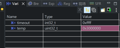

I read PMCR, 0x300 0000, and PC2, PC3 GPIO function is normal now.
0 is default register value from reset, but GPIO is not working.
I think CUBEMX need to generate these switch code if GPIO function is selected.

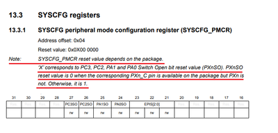

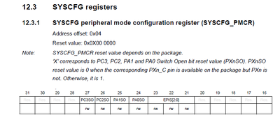

2024-11-14 11:11 PM
The default status of the switches depends on the package:
Also, read this article: https://community.st.com/t5/stm32-mcus/faq-default-state-of-stm32h7-switches-connecting-pxy-c-and-pxy/ta-p/49300
2024-11-15 1:01 AM
anyway, for H755, these bit has to be set for right GPIO function, however SET means OPEN base on datasheet.
but in HAL, it is CLOSE!
something must be wrong.
Peter

2024-11-15 1:42 AM
I mean RM0399 user manual should be revised as following:
1: Analog switch closed
0: Analog switch open
do you think so?
The old is:
