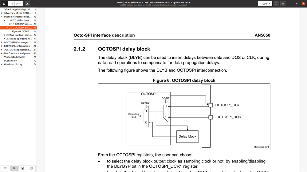

Yes sure you need to enable SEN and DEN to allow the Delay Block validate the setting but the problem here is that you need a free running clock to validate any setting and the Delay Block Input must be connected to the clock...
Let me show you a picture:
I hope the picture taken from annex an5050 is visible.
My problem is that when the hyperbus memory type is selected for the octospi, the delay block input switch automatically to DQS that is correct in general during normal access to the HyperRam but it is wrong during the calibration or any delay block setting because we need a free running clock and the input connected to that clock.
This happens only for HYPERBUS Memory Type that is the type I need to configure....
Yes, SEN and DEN bits need to be set because they enable the sampling of the free running clock.
Without this clock any configuration won't be valid (the valid flag LNGF in CFGR won't be set).
I'm not sure that is the same for any platform but it my case that is stated by the manual :
