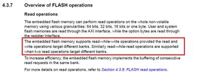

Although it makes absolutely sense, but where can I find this info in the H73x RM0468 ?
There is no read-while-write operation support on H723 like in H743:
H743 (RM0433) :
