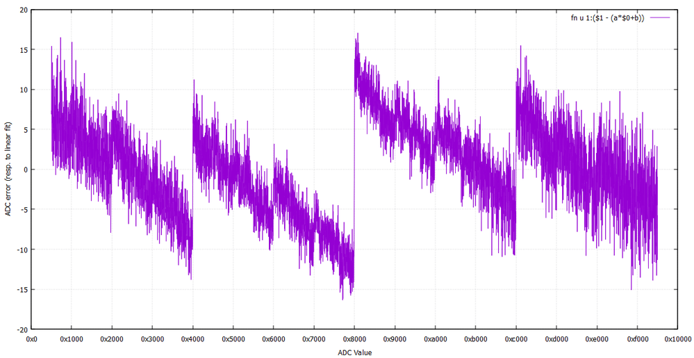

For testing, we use to apply a slow (1Hz) ramp signal to ADC2 channel3 while the ADC is running, buffer a large number of results in memory, stop the ADC when the buffer is filled, and finally read out the buffer via UART.
From the recorded ADC values, we cut out one ramp, and subtract the linear trend line. With the "bad" STM32H752 samples, we always get rather big jumps in the error curve, like this one:
Notably, the jumps seem to occur at multiples of 0x2000. So, we concluded that the calibration for the bit weights does not work properly with these examples.
Our main application is to accurately sinusodial signals around 0x8000, which gets ugly whenever the amplitude is small (because we then work in a small interval around the main dicontoninuity at 0x8000)

The results you showed were very interesting. Seems like something weird is going on internally to the ADC.
It might be hard to get an answer from ST here and they're the only ones with the knowledge of what it's doing at this level. I always thought it was weird that the ADC required linear calibration factors at all.
I have seen jumps in ADC values (missing codes) happen when VREF+ is not stable or not decoupled properly, but those jumps lead to asymmetric results which do not appear to be happening here.

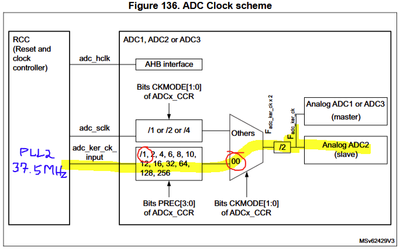

" The BOOST bits are '0b10' in my setup; as I read the datasheets, this should be okay for my ADC clock of 37.5 MHz (before internal "/ 2" division), i.e. 18.75 MHz after the divider... "
Since there is an issue, why not to test 0b11 ?
Have RM0433?
" Note: RM0433
adc_sclk is the system clock or system clock divided by two: when the AHB prescaler is set
to 1 (HPRE[3:0] = 0XXX in RCC_CFGR register), adc_sclk is equal to sys_ck, otherwise
adc_sclk corresponds to sys_ck/2. "
Frankly, I don't understand what it says, as "/2" and "equals to" stated in the same sentence.

2025-03-27 7:51 AM
@MasterT wrote:What I usually do, is checking specific reg to make sure:
ZI2:
Reg: 5C001000 0010 0000 0000 0011 0110 0100 0101 0000 (0x20036450)
Bits 31:16 REV_ID[15:0]: Revision
0x1001 = Revision Z
0x1003 = Revision Y <----
0x2001 = Revision X
0x2003 = Revision V
Bits 15:12 Reserved, must be kept at reset value.
Bits 11:0 DEV_ID[11:0]: Device ID
0x450: STM32H742, STM32H743/753 and STM32H750
Both the device marking and the DBGMCU_IDC register indicate I have Hardware Revision 'V'.
@MasterT wrote:" The BOOST bits are '0b10' in my setup; as I read the datasheets, this should be okay for my ADC clock of 37.5 MHz (before internal "/ 2" division), i.e. 18.75 MHz after the divider... "
Setting BOOST to '0b11' reduces the height of the jumps a bit, but not much (i.e. the "main" jump at ADC code 0x8000 has height ~ 20 instead of ~ 25.
@MasterT wrote:Have RM0433?
" Note: RM0433
adc_sclk corresponds to sys_ck/2. "Frankly, I don't understand what it says, as "/2" and "equals to" stated in the same sentence.
For myself , I'd get RCC-CFGR printed, and changed up and down till I see something.
May be useful: float freq = HAL_RCCEx_GetPeriphCLKFreq(RCC_PERIPHCLK_ADC);
Regarding the clocks: I don't use adc_sclk; I use PLL2P as ADC clock source ("async clock"), which results in adc_ker_ck_input=37.5MHz, and F_adc_ker_ck = 18.75MHz:
Interestingly, HAL_RCCEx_GetPeriphCLKFreq(RCC_PERIPHCLK_ADC)) returns 3750000 (HAL bug?); so it doesn't take into account the fixed "/2" divider in the figure above.
Note that I trigger the ADC via TIM15 every 100µs; and my timing calculation is:
7channels * 16oversampling * (8.5 {tacq} + 7.5 {tconv}) / (37.5MHz / 2) = 95.57µs < 100µs.
When I set the prescaler to PREC[3:0] to "/2", the sampling frequency is halved (i.e. one oversampled sample every 200µs); thus I conclude, that my understanding of f_ADC = F_adc_ker_ck = 18.75MHz is correct.
I also tested halving the ADC clock and compensate by setting oversampling to 8 (instead of 16). With this setting, the jumps remain, but noise is worse.
@MasterT wrote:Regarding code,
reg &= ~0x3Fu; // don't set "rs"-bits reg &= ~(1ul << 29); // disable Deep-power-down reg |= (1ul << 28);I don't know why "u" is appended to HEX value, and why ul instead of UL , could be my C knowledge is rusty.
The "u" (or "U", which does the same) suffix is for "unsigned", and can be ignored here [Programming style: whenever possible, avoid mixing signed and unsigned ints]. "ul" and "UL" suffixes are interchangable in C, and stand for "unsigned long"; which makes sure the operand is at least 32 bits (e.g. on small/old systems where int is only 16 bits).
2025-04-26 12:30 PM - edited 2025-04-28 11:38 AM
I bought nucleo-H753zi, and was able to decrypt meaning of linearity factor words.
First, the debugging hardly complicated by fact, that Reading of and Writing to works only Once. To repeat bit tweaking, Calibration has to be completed again.
It may be possible to guess, that reading works once since bits LINCALRDYW (6-1) must be set, and it has to be done by ADC itself.
But I can't imagine why writing works only once, and RM has no comments on this abnormality.
So ADC-3 Single Ended 16-bits configuration was tested. Linearity factors are ADC bit offset correction, where 200 is default and shifting up/down change the specific bits "weight". ADC-3 is different compare to ADC-1/2, somewhere in HAL written that 7 ( 8? )bits only adjustable, and 11-bits for ADC-1/2.
ADC-3 has 8 bits fields , each 10 bits. Means Words 6-4 responsible to offset bits 0-7 MSB, LSB part 8-15 has no adjustment, Words 3-1 dummy.
Linear regression results, name of picture tells bits number and offset.
Bits-7 shows slope, just because asymmetry since only MSB is shifted, and it's completely different to what your pictures show.
My conclusion, that 4 saw-tooth like presented in initial message are not related to calibration, but I 'd re-check on adc-2 later on.
