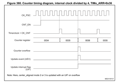

2025-04-26 8:51 AM
What chip are you using?
Step through the code and, when the timer is enabled via the CEN bit, ensure that CNT=999 as you have set it. Consider setting the timer update frequency to 1 Hz so you can examine the registers at human speeds to see what's going on. I didn't test it but the Reference Manual is likely correct. It may not be possible to do this with HAL. If you are particular about the very first pulse, you may need to write your own code, but if you just want TIM1 and TIM8 to be offset, as it appears, should be able to do that with HAL.
