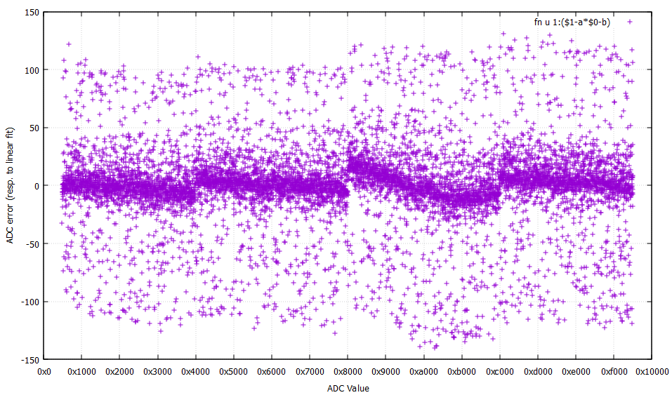

From the recorded ADC values, we cut out one ramp, and subtract the linear trend line. With the "bad" STM32H752 samples, we always get rather big jumps in the error curve, like this one:
Notably, the jumps seem to occur at multiples of 0x2000. So, we concluded that the calibration for the bit weights does not work properly with these examples.

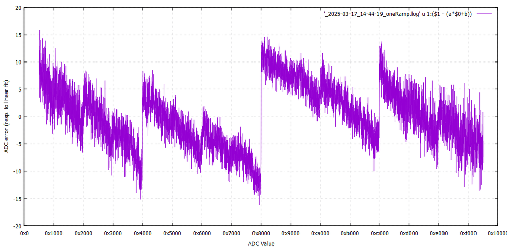

HAL_ADCEx_LinearCalibration_SetValue(&hadc2, lincalbuf);A bit surprisingly, this gave us much a more "continuous" error curve, with all our parts ("good" and "bad"), e.g.

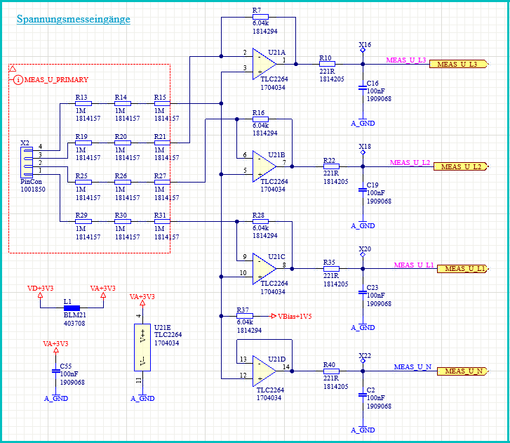

I'm curios how exactly you drive adc inputs, mind to show circuits? Draft, hand sketched ?
2025-03-19 1:36 AM
Sure, here is a part the schematics of some of our measurement channels:
The nets MEAS_U_* are directly connected to the STM32H753, i.e. the ADC inputs. VRef is +3.0 Volts (not shown), and VBias+1V5 is derived from VRef.
For testing, I applied a 1 Hz, 600 Volt voltage on X2 between pins 1 and 4, and looked at the ADC samples of MEAS_U_L1.
I doubt that the jumps in the measured signal stem from the input circuitry, since firstly, it works for the majority of our parts, and secondly, even the bad parts seem to work when applying our "manual neutral everything:=0x200" calibration.

" For testing, we use to apply a slow (1Hz) ramp signal to ADC2 channel3 while the ADC is running, buffer ....."
There are things I'd measure:
1. Voltage across 100nF capacitor of not driven neighboring channels.
Sure, circuits is not correct, even small 4pF S/H capacitors running at 1 MSPS presents about 40 kOhm load, so error in conjunction with 221 resistors already ~0.0055 or at 11-th bit. Plus charge re-distribution over all channels plays tricks, so first things to try is to short all other channels to ground.
Better, of course, use newer high speed op amps (>50 MHz GBW) and low series resistance.

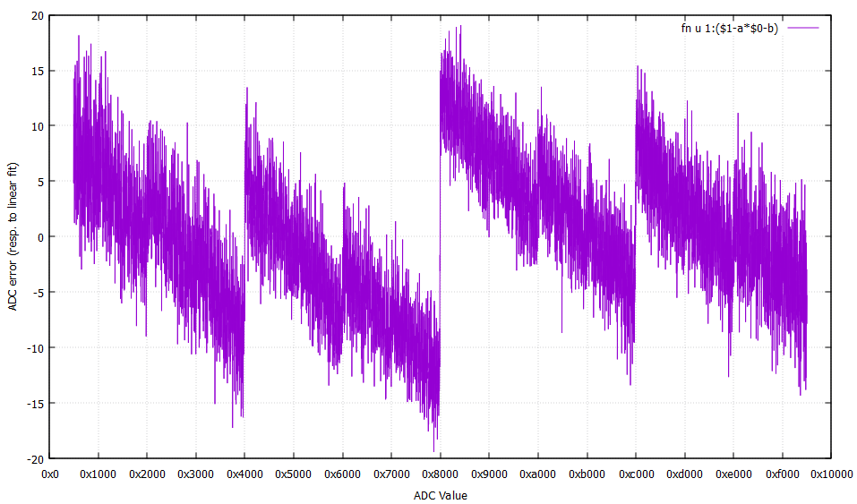

for testing, I shorted R35 (previously 221 Ohms), and removed C23 (previously 100nF) in one affected device. Result: the overall noise increased, and the systematic errors ("jumps") remained. So, this only made matters worse.
Then, I swapped U21 (the quad OpAmp) for a AD8608 (10 MHz GBW), which did not help either:
(Noise is worse by a factor of approx. 10; and the "jumps" in the transfer curve seem to be rougly the same)

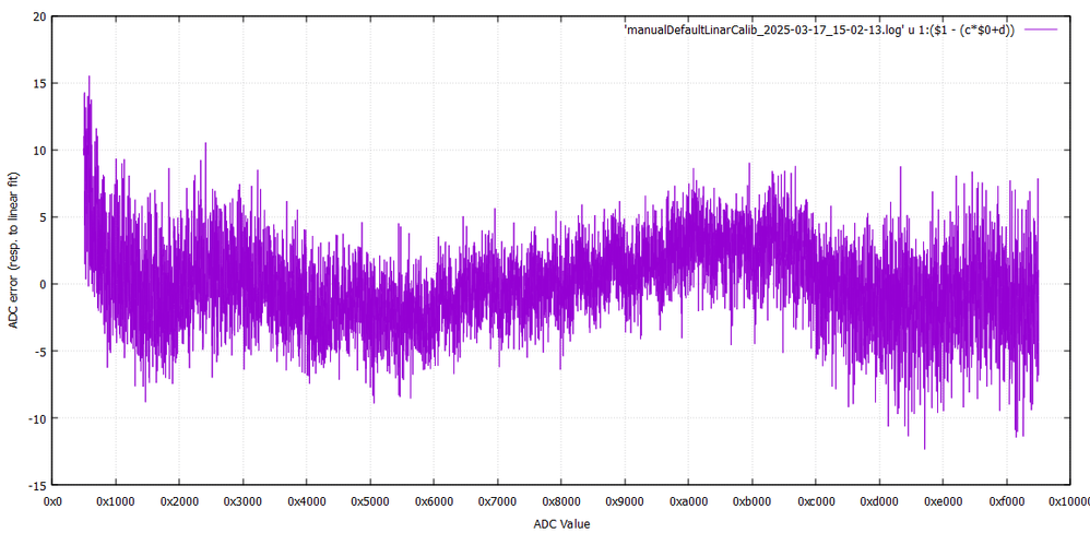

Thanks again, you seem to have a good intuition:
with R35=16.5Ohms, C23=2.2µF, the noise level is very good. Alas, the jumps remain:
