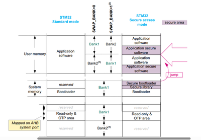

look at this diagram too

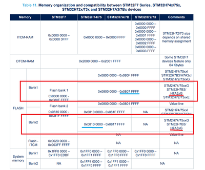

Hello @b1aze and welcome to the community.
You can't do that with STM32H7A3VG:
FLASH (rx) : ORIGIN = 0x08000000, LENGTH = 1024K
STM32H7A3VG has two banks of 512KB and they are not contiguous:
From AN5293 "Migration guide from STM32F7 Series to STMH74x/75x, STM32H72x/73x and
STMH7A3/7Bx devices" / page 22:

You can't concatenate both regions in one Flash bank. This was almost said in my previous post.
You need to use another part number having contiguous Flash banks (2MB of Flash size), Ex STM32H7A3xIx:
